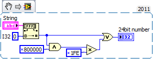

As JB's link doesn't work for me (right now as NI website seems to have its problems) I attach this snippet:

That's a pretty clever sign extension, but a little difficult for me to wrap my brain around. An alternative to let LV do it for you would be to use a 24-bit fixed-point type for the conversion:

Hi JLewis,
get the sign bit, multiply it by 2*255 to fill the upper 8 bits of the I32, OR it with the remaining bits of the number…
