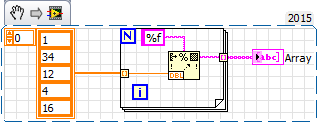

@rr1024 wrote:
unfortunately the value I want is in a 1d array to start with so a straight conversion won't work and labview doesn't seem to have anything useful to convert floating point to string
It is called Format Into Sring
much less a floating point in a 1d array to a string which I've been searching for.
Is there no 1d array floating point to floating point string converter
No.  But you put the Format Into String into a For Loop.  Auto-index on the input and output tunnels.

@rr1024 wrote:
unfortunately the value I want is in a 1d array to start with so a straight conversion won't work and labview doesn't seem to have anything useful to converst floating point to string much less a floating point in a 1d array to a string which I've been searching for.

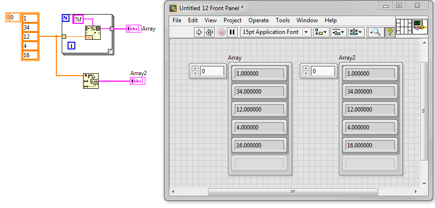

This is just not true. The Number to Fractional String function can recieve an array of numbers. There is also another function in the same palette that goes back the other way.
If you need fancy formatting for your string use the Format Into String node, as suggested above, inside a For loop. The Format String for that can be something like "%.2f" if you only want 2 decimal places. Use the Help window and documentation for more options.

@RavensFan wrote:

That is frustrating... Same thing, dude. This function as been in this thread from the start.
