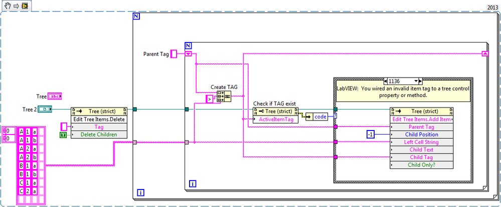

Got it!
Here's the changed vi. if you have any advice on how I can improve it, please let me know
(5,003 Views)

@Omar_II wrote:
2D Array of Strings to Tree Control.png2D Array of Strings to Tree Control.png
This was what I first came up with before seeing your 2nd post.
Your solution seems to be much more streamlined. although mine is recursive. I wonder which will be better as list size increases. I think I'll stick with mine though as it can handle different depths as well (in case I ever need one to be C 2 a i )
