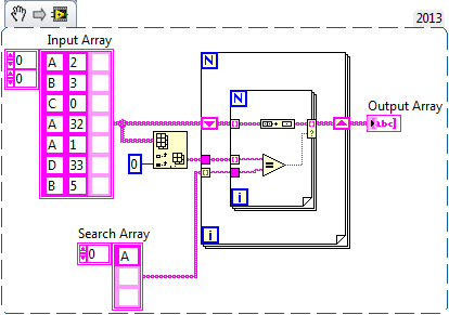

This might be simple, i didnt get the trick to do it. When i do search "A" it accumulates 2D array of data having A information of the input array. Similarly if do search A and B using search Array input. I need to select and display both A and B info in the output 2D array.
any directions on how to get this.

I would flip your loops.  Autoindex on the input array on the outer loop and autoindex on the search array on the inner loop.  You should also use the autoindex output on the outer loop.
