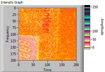

The Z-scale of the intensity graph is 8-bit, so the closest you can come is by converting the picture to 8-bit using Picture to Pixmap.vi and Unflatten Pixmap.vi.
Then you need to set the intensity graph so that it transposes the array (right-click option) and change the y-scale so it increases from the top (type 0 into the top marker and it will flip).
