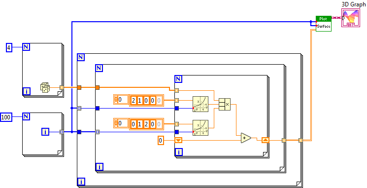

perhaps this method can work?
https://forums.ni.com/t5/Example-Programs/Display-Point-Cloud-in-3D-Picture-Control/ta-p/3497874
you just have to modify the XYZ-bundle array to the coordinate of your threshold points
