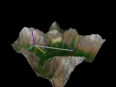

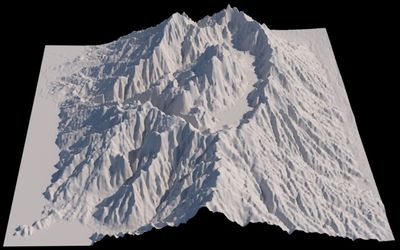

If you can use a landscape approach, you'll have a 2D array, and height would be the 3rd dimension.
shape_heightfield
(http://www.mitsuba-renderer.org/devblog/2013/11/)
There can't be caves (concavities).

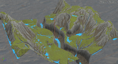

or be based on another value:
01_terrain
(http://ikatnek.blogspot.com/2017/11/terrain-bake-textures.html)
