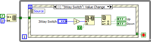

Another option might be to use a radiobutton control as follows (make sure to "allow no selection").
Message 35 of 40
(3,256 Views)
Thanks.  That works, too.  I'm copying it into my 'Switches' folder.  However, it takes away the ability to change the Mechanical Action.

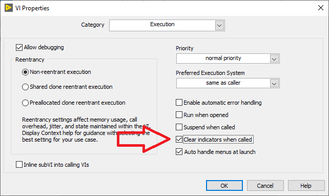

One more  thing. Note that if you would change any of the LEDs to TRUE at edit time and run the VI, they will remain lit until the  3way switch is operated at least once. To fix that, got to VI properties...execution and enable "clear indicator when called". Now they reset whenever you run the VI without the need of any additional code.
Message 38 of 40
(3,229 Views)
@altenbach wrote:
@rkesmodel wrote:
Here is the better version, if any are interested.  I am a little disappointed that no one took me up on creating the horizontal version.  I will see what I can come up with.
One more  thing. Note that if you would change any of the LEDs to TRUE at edit time and run the VI, they will remain lit until the  3way switch is operated at least once. To fix that, got to VI properties...execution and enable "clear indicator when called". Now that reset whenever you run the VI without the need of any additional code.
Cool. Thanks.
