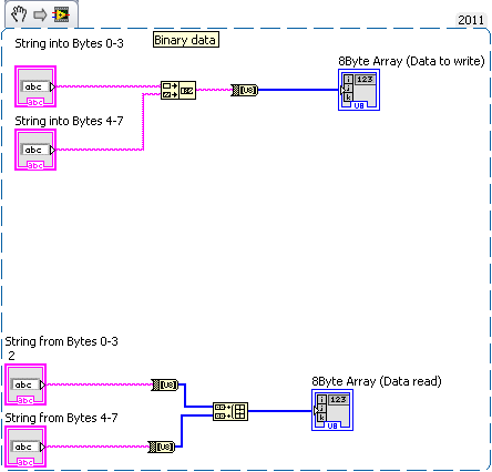

Hi, I've attached an example of what I need to do. I have 2 strings I need to convert to an 8Byte output array, then I need convert the 8Byte array back into the 2 4byte strings. Does this make sense?

The most basic method would be this:

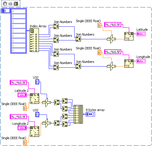

       Look at my solution, is it what you need?
Best Regards,
Luis A. Mata C.
Ing. Electrónico
Whatsapp: +58-414-1985579
BBM Pin: 2B83E99A
Thanks: Kudos
Message 9 of 14
(6,078 Views)
Thanks Luis, this is exactly what I needed 😃  Could you post the VI example for it?
