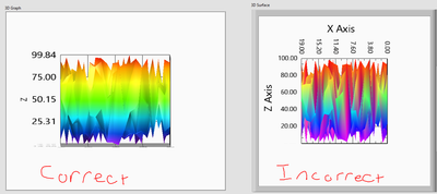

  • The 3D Surface does not have the correct color grading while the 3D Graph does.

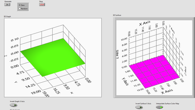

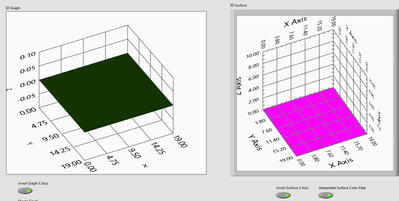

  • The 3D Graph does not have an invert axis option. Inverting the min/max with auto scale off is a workaround, but it also flips the 3D lighting. It is very apparent if the graph has flat portions.
Normal:
Inverted:

In short the 3D Surface has all the options I want/need to manipulate my data but it does not color the plot correctly. On the other hand, the 3D Graph does color the plot correctly but is missing a lot of options that are available to the 3D Surface for transforming.

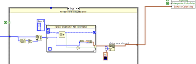

it is worth mentioning, the 3d Surface plot (incorrect, which should look like correct) does allow user-defined color ramps, which must be retrieved once from the original 2d image.
e.g. https://forums.ni.com/t5/Machine-Vision/Convert-2d-Gray-color-image-into-3d-x-y-z-graph/m-p/4256891#...

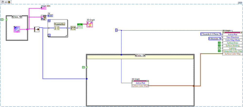

From what I gather from your post though is that 3D Surfaces use Color Ramps while 3D Graphs use Color Maps, which are different data types. Is this correct and if so would it be possible to apply a Color Map to a 3D Surface?
Apologies for not down-saving, I've attached my example vi but saved to the 2017 LabVIEW.
