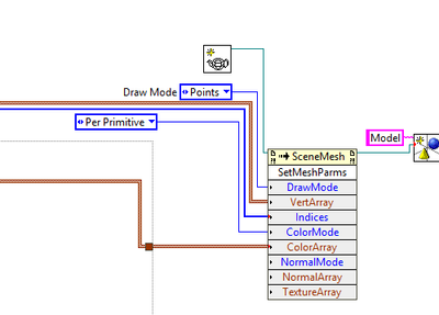

I just opened your example and the elephant loads just fine! I tried converting the data I have into an array of clusters of x,y,z points but it does not populate in the 3D picture.
Is there a specific way the points need to be arranged for this to work?
Message 6 of 27
(8,763 Views)
The way that you constructed your point array looks fine to me, assuming that the outer loop is for each slice and the inner loop is around the tube.
I cant remember exactly, but my bet is that it has to do with the order that you are trying to draw your points(at least for triangle draw). If you change the draw mode to "points" you should be able to see exactly where each point lives in 3d space. If you do this before you interpolate your data you should be able to verify that you have the correct (x,y,z) points. If I remember correctly the triangle draw mode didn't always produce clean models for me. There are a few different draw modes, you might just have to play around to see if there is one that works better.
