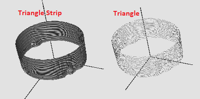

Alright! So I got it to work after doing some more fancy footwork with how the points are stored in the array. Now "Triangle Strip" produces a wonderful surface.
Only question now is, how do I get it to show shading? I added a light source to the model, but it doesn't seem to make a difference.

For the shading to work, you have to provide an array of normal for your surfaces. Notice that you will get consistent results only if each normal is normalized.
Have a look at this post. It might give you an idea on how to proceed.

Is there a change I need to make to the normals if the drawing mode is set to triangle strips? Triangles gives me a terrible render.

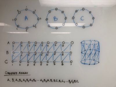

EDIT: Maybe my current methodology would be helpful.
Because I have an even number of points in each "slice" I interleaved the data to allow points to create triangles.
In the picture example, each "slice" has eight points. I append the first point of each array onto the end of the array so that the circle actually wraps back onto itself. My algorithm currently interleaves slice A with slice B, then interleaves slice B with Slice C and appends the two interleaved arrays onto each other. So your array ends up being A1,B1,A2,B2,...A8,B8,A1,B1,B1,C1,B2,C2...B8,C8,B1,C1. I do this for (number of slices - 1) to get a full meshed model. Correct me if I am wrong, but to make the "triangles" draw style work the array would need to look more like A1,B1A2,A2,B1,B2,A2,B2,A3....etc. correct? Where each triangle has three points to themselves.

You are correct. You can use triangles instead of strips by using 3 indices for each triangle.
Looking at your rendering using strips, I think that you have an issue of "flipping" normals. Depending on how you select you points to calculate each normal, the normal can be either up or down (or outward or inward). You need to find a way to make the normal consistently in the same direction (outward would probably provide the best appearance).
