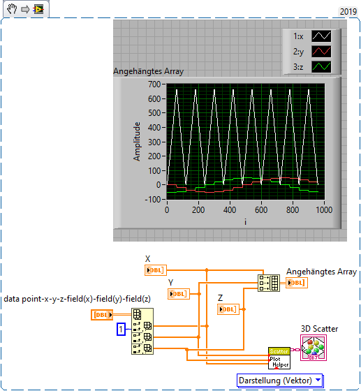

Scatter Plot shows the expected pattern of data point positions. Not sure what math needs to be done to plot the correct X-Y-Z positions in a quiver plot. Also not sure how to plot the quiver plot arrows using single axis data for x-y-z data. Maybe this can't be done??? What I expected to happen was an arrow at the data point at the x-y-z position it was taken and then the arrow pointing in a direction dictated by (field x-y-z data).

Your code makes little sense.
Why would you need to index out the same data 3x in parallel (upper left)? Are you aware that "index array" is re-sizeable? You only need exactly one instance? Can you describe how the "field" is defined and what the units are? How should the graph look like?

I forgot index array was resizable.-Thanks  The data is a measurement of magnetic field at different location in a circular pattern. The location of these measurement is index array 1,2,3(x,y,z). The magnetic field measurements are array index 4,5,6 (field-x,field-y,field-z).  I assumed I could make something that looked like this.

I forgot about the index array was resizable.-Thanks My data is magnetic field measurement taken at different locations in a circular pattern (shown in the scatter plot). These locations are array index (1,2,3 x,y,z). Then there is the magnetic field measurement taken at each of those locations. These measurements are array index (4,5,6 x-field,y-field,z-field). I figured I could make a plot that looked like this.

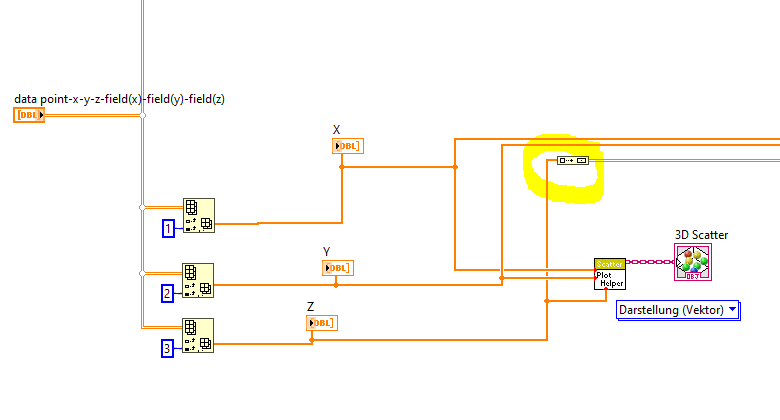

are you sure you haven't mixed up x and z position in your data array?
I assume index 1 white is meant to be z not x ?
on thing I am pretty sure about your code is, that the following won't work to interpolate a 1d array to a 2d array:
the above will transform your 1d array to a 2d array with one row.

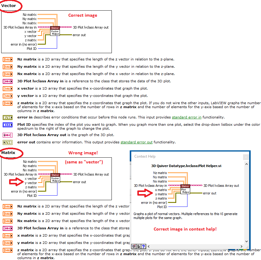

according to
http://zone.ni.com/reference/en-XX/help/371361R-01/lvpict/3d_quiver_plot_vi/
z matrix is a 2D array that specifies the z-coordinates that graph the plot. If you do not wire the other inputs, LabVIEW graphs the number of elements for the x-axis based on the number of rows in z matrix and the number of elements for the y-axis based on the number of columns in z matrix.

OK, glanced at this for a few seconds and the help seems quite confusing. For example the image for the "matrix" version is incorrect. It is also not obvious what e.g. (a 2D array that specifies the length of the vector z (or x or y) vector in relation to the z-plane) actually means. The shipping example is just a bunch of array diagram constants wired to the helper.
This VI graphs "normal vectors" to a plane, while you want a 3D vector field without any plane. So this would seem to required a bit of math. Also, you can only define a global color for the arrows. Weird is that for some quiver colors the arrows differ in color between head and tail (try green or blue) while for other colors they are the same (try red or black).
It might be easier to create a 3D picture instead, e.g by placing cones of desired colors in desired locations.
