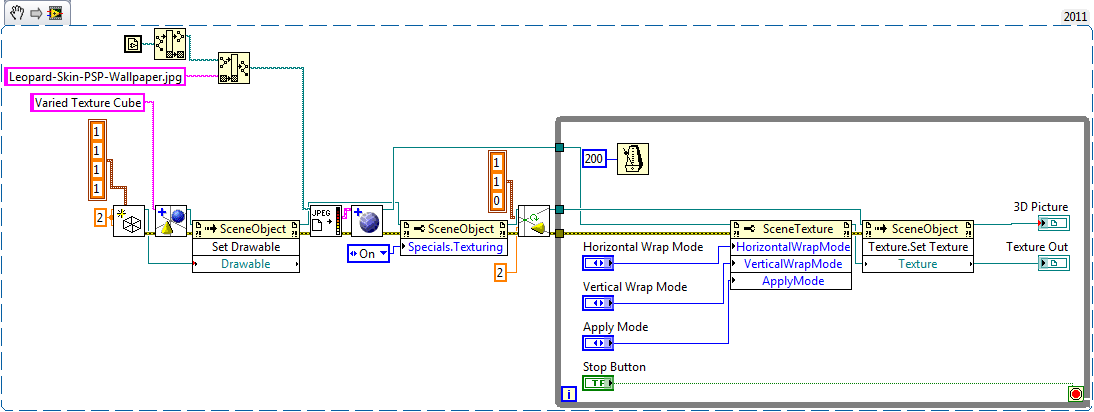

Below you'll find the block diagram required to texture a cube object and set it in the 3D picture control in LabVIEW.
If you download the zipped folder and extract the files, you'll find a VI that draws a 3D cube and textures it in very snazzy looking leopard print.
There are a lot of property nodes involved, each all necessary in order to produce this output; but if you play around with the solution you'll see the effects that they all have. To learn how to do this, I used the solarsystem.vi example from the NI Example Finder. (Help > Find Examples...)

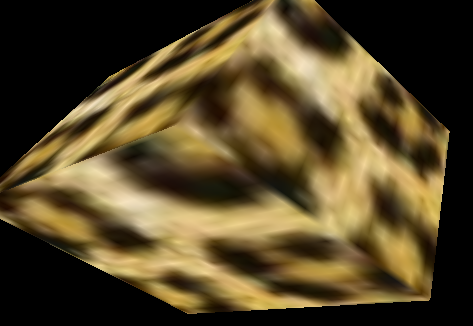

I've tried experimenting with the different settings that come with the texture property node for a 3D object, and I've attached the VI so you can try out your own settings for the objects. As far as I can tell, the image is scaled to suit the face which it is placed on; you could see this in Darin.K's VI as the cube images he used were based on the relatively small user thumbnails.
In the attached example I made the leopard print image very small to see what effects placing it on a large cube would have, and it resulted in the following output:
I also tested what happened when I used the full resolution image of the print for the texture, and received this output:
By changing the different texture options on the texture property node, you can see what effect this has on the output of the 3D Picture Indicator.

Thank you Alex, that's just what I feared. So the only possibility to adapt the object and the image is using a mesh or scaling the cube.
