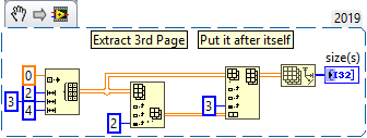

By "Page", I assume you mean the 2D array indexed by the third Array Index.  Use Index Array with the third Index wired to the Page you want, and use Insert Into Array (assuming you want to Insert, instead of Replace).  Here a Snippet:Insert PageInsert Page

Hi, Bob:
I did not state my problem very well.  (It seems that I can dispense great advice with how to do that, but I can never accomplish it, myself.)
I meant that I couldn't find a way to select the displayed data from the front panel (in dev mode) and copy it to another "page".  I could select individual elements and copy them, but not multiple.  There's some tantalizing menu selections in the "advanced" menu about selections, but I couldn't figure out hot to use them.

Yikes!  On the one hand, I'm glad the Question I Answered was not the Question You Were Asking (I was getting a little worried about you!).  However, I'm still unsure what it is you want to do.
I just did the following -- I had a VI I was examining that a Forum member had posted, and a blank VI I created with Ctrl-N.  I selected multiple elements from the Front Panel of the first VI (using Shift-Click to select multiple individual elements), then Click-Dragged them to the Blank VI.  Not only did those selected elements Copy, but they retained their Front Panel spacing and names.  Is this what you are trying to do?
I did look at the routine you mentioned in your response, but am still unsure that I "understand the problem".  I probably need to take a nap ...

Thanks for the explanation -- I still didn't "get it" until your last post.  What I now think you want to do is to "select a page" from a populated Front Panel Control (or indicator) and copy it for use somewhere else.  I have no idea how to do this in any "direct" way -- what I'd do (if I needed to do this) would be to combine the two techniques I "misunderstood" earlier --
  1. Click-drag the 3D Array (as is) to a blank VI.
  2. Create a tiny LabVIEW program on the blank VI to alter the 3D Array, moving the selected Page, as you wish.
  3. Move the updated 3D Array back to the original VI (with a new name, if appropriate).
Note that you do the "manipulation" on an isolated VI, so you can inspect what you've done and make sure you "did it right" without risking the original VI.
Bob Schor
