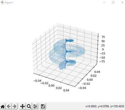

The Advanced Plotting Toolkit is actually a very nice API wrapped around (a pre-2015) Python and the Matplot Package.
So, you might as well just learn how to render a 3d Quiver Plot (or 3d vector field...) directly e.g. start with
https://matplotlib.org/stable/gallery/mplot3d/quiver3d.html
assuming you want to render something as the original OP discribed in the first message
Spoiler
import matplotlib.pyplot as plt
import numpy as np
ax = plt.figure().add_subplot(projection='3d')
# Make the grid
z = np.arange(-90,90)
x = np.zeros(180)
y = np.zeros(180)
# Make the direction data for the arrows
w = np.arange(-90,90)/30
u = np.sin(3*w)
v = np.cos(3*w)
ax.quiver(x, y, z, u, v, w, length=0.05, normalize=True, linewidth=0.75, linestyle=(0,(1,1)) )
plt.show()
