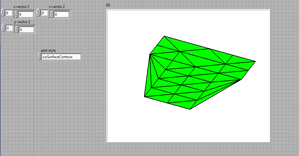

halo everyone, I have some difficulty in constructing the structure as in “capture 1” using labview, the outcome from labview is displayed in "capture". thanks is anyone can help on this. 😃

Please show us all of the relevant LabVIEW code.  You appear to be using something called Component Works, which does not show up in the standard Palettes I have installed on my system.  It appears to be some sort of ActiveX Object, which suggests that there is a "missing manual" that explains the Methods and Properties associated with this Object.
Note that I was able to find a manual, dated 1999, for NI's Component Works, but didn't bother to read it as I don't have any code to inspect.  Might there be other/better/more relevant tools to handle whatever task you really want to accomplish?  [Why not tell us what you want to do?].

you can use the Basic Properties VI
But you will have to make a few plots, because with one obtained the following picture:

You may find this thread useful.
I posted to that thread with a bunch of CW-3D graph examples. The links in that thread should take you to various thread were the ordiginal code is included.
The connecting lines between points depend on the data you present to the CW-3D graph, the order in which they are presented, and the plot style you are using.
Most of the chalenge in getting the 3-D plots to work is figuring out what is the right shape for your data.
Ben
