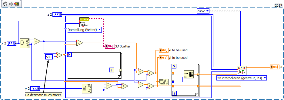

Interpolate2DScattered.vi takes to much time to execute. I will need to create grid as following picture and run time is about 40 minutes with for loop in parallelism mode ..
I need faster algorithm...

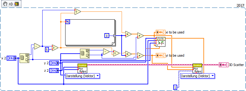

For a start I would use smaller arrays here! Do you really need to interpolate giant 2D arrays?
You should have noted in your first post you want to interpolate 2D arrays: just use a different polymorphic version of Interpolate2DScattered:
- did you notice what I have done with your two for loops generating Xi and Yi? I did this for a reason…

I was not aware of having 2D polymorphic instance of that VI. I have to decimate at least 50 value instead of 500
Yes I need that giant 2d array to interpolate. I will be having similar second dataset.which will be interpolated ,
For both dataset X,Y will be same and Z1-Z2 used for calculation..
(4,347 Views)
