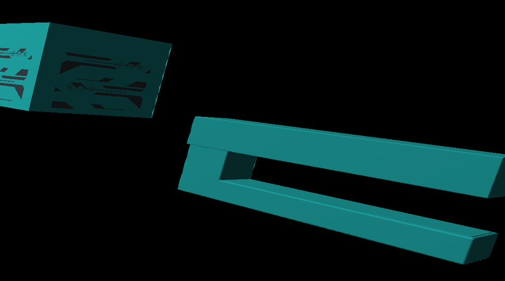

I have a complex of 3d models. And I want to apply textures to this models. But I have a trouble.
First: when I apply the texture to c-form, I get flat color.
Ok, maybe I'll split this form into priomitives, but when I apply the texture to cube, I see edges with repeated textures.
Can I apply something like this?

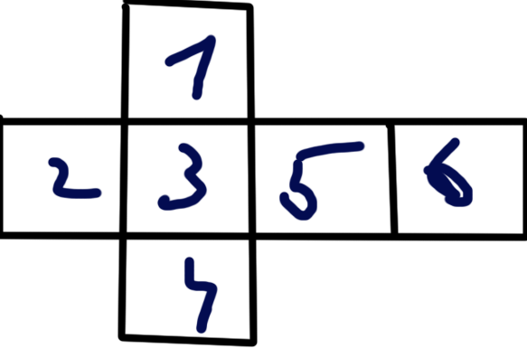

I want to properly apply a texture to an object.
in my example, I have to get a real game bone (1-2-3-4-5-6), but I get all the edges the same.

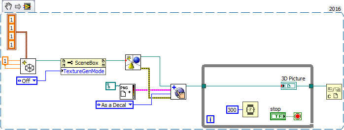

Which property?
I tried GenMode, but without success

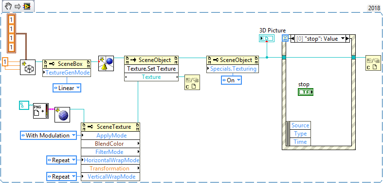

Those VIs are pretty limited in what you can do, and actually occlude what's happening, IMHO.
Try doing it manually (sorry, can't make a snippet for a previous version):
The same goes for the box. If you make your own box (or other object) from raw coordinates, you get the option to specify texture coordinates.
So this won't do what you need, but it will bring you tons of options to experiment with Smiley Wink.
