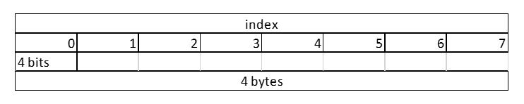

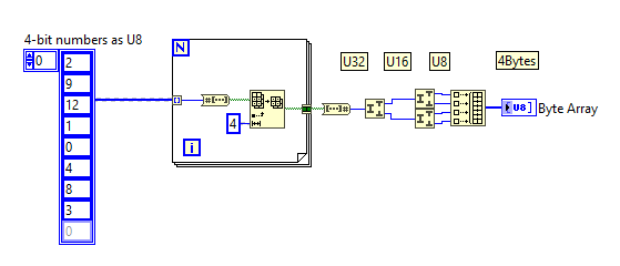

My goal is to to take eight 4-bit numbers (8-bit numbers constrained to decimal value 15) and create a U8 array which my device can interpret. Here is a picture, showing that I want to end up with a U8 array of length 4.
I have a solution that gets me the correct array size. Is there anything in here that seems like a very roundabout way to do things? I am going to scale this up to work with an input array with 8192 elements, so If there is a way better on memory that would be useful too.

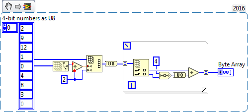

This code works as well.  I benchmarked it and it was considerably faster, running 1 mil calculations in 0.51 seconds vs 4.31 seconds.4Bit Numbers.png
Edit:  My output array is reversed from yours for some reason though.  If this is going to hardware I'd do a sanity check to make sure you're getting the bits in the correct order.
This method also uses considerably less memory.  You have one extra byte that is getting thrown away at the end of each conversion whereas "Number to Boolean Array" causes each bit to be stored in memory as a byte (Booleans are stored as bytes in memory)

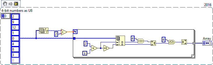

The following code will give the resulting byte array but reversed. Assuming the initial array has an even number of elements range 0-15.
I'm pretty sure a knight will come with a way better solution!
Ben64
EDIT: Seems Bowen beat me with a similar solution!

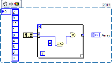

Here's my "Extreme minimalist" edition.  Didn't benchmark it though.  Should scale to any input array size so long as it's even (if not, it'll need to be padded or it clips the last one).
I was curious so I did the benchmark compared to my solution.  Mine is still a tiny bit faster (2.413 seconds for 5mil calculations vs 2.523).  SO, I made a combination of our two methods... trashed the "Decimate 1-D array" and kept the indexing because it is faster.  Then trashed my Join Numbers, Rotate, Split method because the "Or" was much faster.
Result was down to 1.65 seconds on 5mil calculations!

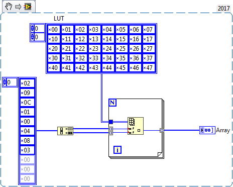

What about a simple Look Up Table. Did not do a benchmark, but I would guess it's as fast as the other examples.
EDIT- If you don't like the bit/byte endianness, you can transpose the LUT.
EDIT - Just ran a benchmark and it took 25 milliseconds to pack a 5 million byte array
 This is the resulting array (shown as Hex).
