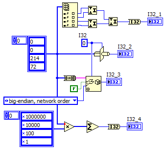

Hi Richard,
several options:
All of them give "54856" (=214*256+72) as result…

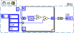

Hi Richard,
one more option:
(You might use one of the other options instead… :))
Message 7 of 19

Hi Crossrulz,
Ive noticed i'm not getting consistent results from the type cast function, which is annoying!! However, the self indexing for loop Gerd posted seems to be the most reliable method. Is there any drawbacks to using the method? Is it more intensive etc??
Richard.
