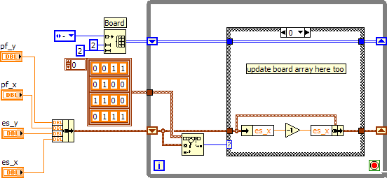

In fact, I had been trying a small part of the C program (a few if condition) in LabView 8.5.  Eventually, I ended up with many local variables.  Please give some advice.
Message 16 of 41
(1,517 Views)
You need to think about it completely differently. Figure out what the program needs to do, independent of the language that you're using to do it.
Here's one possible very basic starting point.
Message 17 of 41
(1,497 Views)

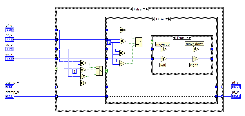

I am not sure what you are trying to do.  I do not read C. However, it looks as though you never assigning values to ptemp_x and ptemp_y in the C code segment. You also do not assign values to them in the LV code under some cirmcumstances.
I doubt you need those (temporary?) variables at all.  In LabVIEW the WIRE is the variable. A local variable is a link to a control or indicator. Controls and indicators are for human access to data, not the data itself. With a few specialized exceptions local variables are rarely needed.  Try to do it without using any local variables.
Other comments: The data type should probably be integer, not double.  Equal comparisons on doubles can be problematic due to the finite representation of fractions in binary.  If the data will never have fractional values, use an integer datatype.
Use the =0? primitive to eliminate the need for the zero constants. Use the compound arithmetic node set to AND mode and expanded to 4 inputs.
Get rid of the sequence structures. Learn to use the power of dataflow.  Your sequences do almost nothing.  The one in the innermost case structure decrements es_x and es_y and increments them tiny fractions of a second later.
Here is a first step toward cleaning up your code. Note that it is not complete because I could not tell what some of it was supposed to do.
Lynn

Could you please attach the vi for labview 8.5.
Message 19 of 41
(1,491 Views)
Ah, sorry, somehow misread 8.6 instead of 8.5 in the earlier post, I did mean to save it in the right version for you.
Here you go.
Message 20 of 41
