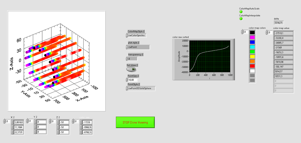

I love it!!! I picked cwColorSpectrum point style. How do I add the graphs color legend? So you can tell what the color equals what value.

roll your own:

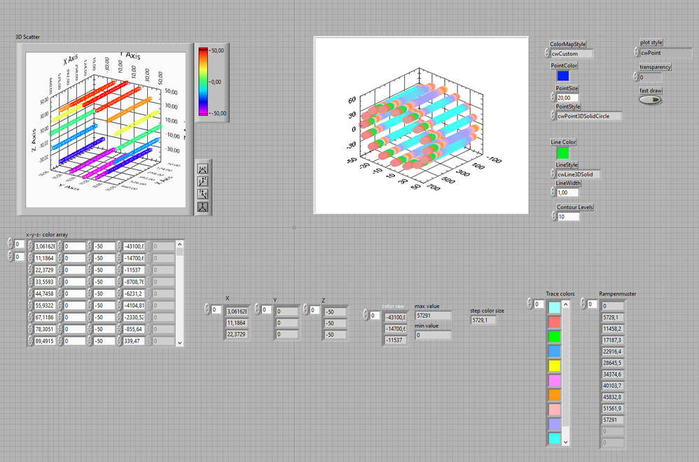

attached is my quick draft, saved in LabView 2017
10-15-2019 09:54 AM
Sorry for the delay I had to work on another project. Good idea on your work around. I tried it with other data sets and would sometimes error out if two values in color array were the same. I ended up using windows snapping tool and cutting legend out and placing array in min/max indicator next to legend.
