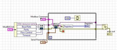

Hi
thank you for taking time to read my query. i have a working modbus which can read  the  modbus registers in binary but, i don't know how to represent those binary representation using 16 leads for 0 to 15 binary (1's [led status - on] and 0's [led status - off]) can any one help me on how to do it

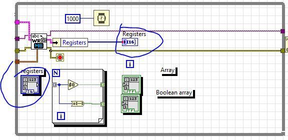

@Artem.SPb wrote:
If doing the Not Equal To Zero, no loop is required.
GCentral
(3,245 Views)
can you send the vi for this for loop if i am right its indexing
(3,225 Views)
Yes, it is indexing.
And what was posted is called a "snippet'.  Save it to your PC and then drag it to your block diagram and you will automagically have the code.
GCentral
(3,218 Views)
how do i do it for this one here
(3,191 Views)
Accepted by topic author Etesam23
I guess you didn't try to learn what was going on in the code you downloaded, or you'd know how to use it.  Study the code so you know how it works.
