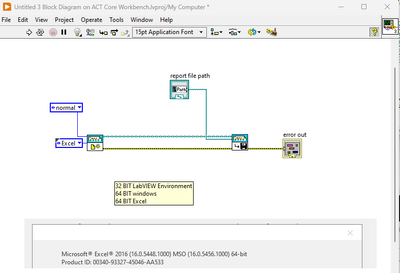

I have recently installed Both LabVIEW 2024 32-Bit and 64-Bit development environments.  I am running into issues related to Microsoft Excel (Excel 2016 64-Bit) when operating from the 32-Bit LabVIEW environment.  This issue has come up before and I have read through many threads going back to LV2017 surrounding the Report Generation Toolkit and issues with various iterations of Microsoft office (360, 32-bit/64-bit and various office year versions).  The specific issue is that when trying to use the "Save Report To File.vi" from the toolkit, the call fails with an error:  Some other threads that I have read through reference this type of behavior, but nothing comes up more recently.  I have tried 'repairing Microsoft Office app' through windows settings with no luck.
I'll probably phrase this wrong but...How do I point LabVIEW 32-BIT to the proper library to get the property node members and functions which seems to be the issue?  Using the LabVIEW 64-Bit environment is an obvious solution, but it presents other issues that do not pertain to this topic.  Using a 32-Bit version of Office is not an option either in my situation.  And, as I've asked before in a previous thread, how is it that some of these property node calls are able to operate and others aren't?  I'm able to open Excel, Insert Text, but saving is an error.

Two main topics come up discussing this type of issue going back years.  Two main issues are discussed.  First is "broken vi's".  In my case there are no broken VI's.  The second issue involving the ActiveX calls (property and invoke nodes) not able to find the proper dll's (or whatever it is that they are finding the member properties and functions from).  The second case seems to be the issue.  When I dig into the RGT vi's I get down to property nodes that can not find members.  They show as if they exist, but if I were to drop a fresh property/invoke node and wire it to the reference I get no visibility into the functions/members.
What is strange about this is that the toolkit seems to be able to use the RGT and ActiveX calls for most of the functions.  This one in particular fails with an error and I create and save a new document.  I have generated an identical VI using the LabVIEW2024 64-Bit environment and it operates flawlessly.  Here's a screenshot of the simple Open and Save VI that I am using as a test:

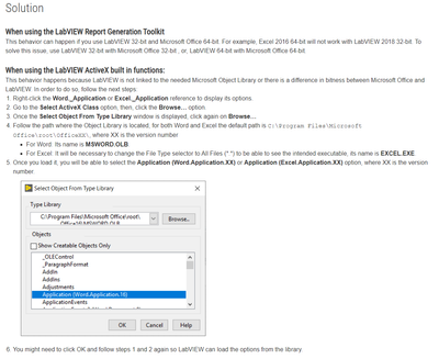

I'm not sure if you tried this but I found that is helps to relink the nodes.
https://knowledge.ni.com/KnowledgeArticleDetails?id=kA00Z0000019KZNSA2&l=en-US

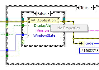

When I tried running your demo or even using RGT Create Report.vi my LV2021 32-bit crashed. I'm running Windows 10 and Excel 2016 64-bit. I tracked it down to the subVI NI_ReportGenerationToolkit.lvlib:Excel_open.vi. (Shown below)
For some reason the crash happened when the property node was reading the Version so I removed it and Excel now opened without crashing LabVIEW.

Thanks ooth!  Well, that seems to answer that question.  LV32bit just won't work with Office 64Bit.
So, how does it 'sort of work?'  In my case, it opens excel just fine, I can add text using other RGT vi's, but it fails with error when attempting to save the file.  Is it loading the 64 bit dll's or something and they are quasi compatible?  I might just have to bite the bullet and address the other reasons that I reverted to using LV2024 32-Bit instead of LV2024 64-Bit.
So, I followed the procedure for pointing the Excel._Application reference to the EXCEL.EXE and voila!  Seems to be fully operational now.  The save function now works without modifying anything else.

I'm glad to hear it worked. The only problem (for me) is when I apply the solution LabVIEW doesn't remember the fix. What I mean is next time I open LV the property nodes show "No Methods" if I click on them. But the VIs run and work correctly so I'm not too concerned. Only if I have to change something do I have to re-apply the solution so all the options show up again. Probably has something to do with how Office was installed on my PC.
