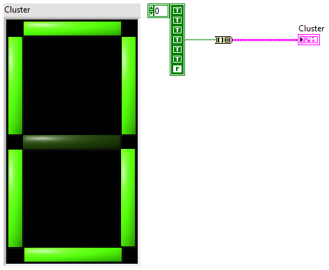

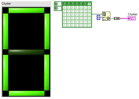

get 7 leds into a cluster, reorder them (a-g) as #0-7 and use the array to cluster function...dont forget to size that function,otherwise broken arrow. make your pattern with your bool arrays into a 2D. then just index the # to output the 1D pattern that matches
