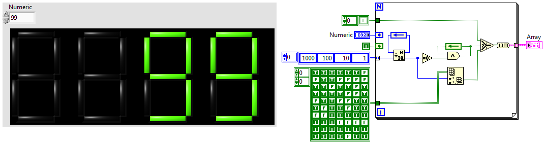

@apok wrote:
here's something fun.....hijack'd Smiley Tongue
Here's a 10digit version I made back in 2010. (use format %010d to show leading zeroes).

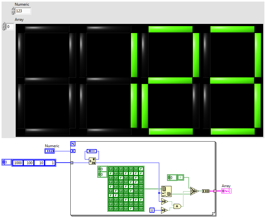

i hope i did not rube on this, but it took care of the leading zero's...
