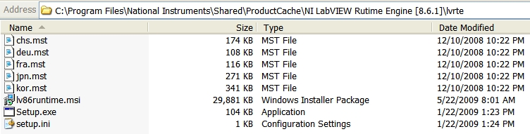

This problem is with the runtime installer files and not with the installer itself.  For some reason my Labview 8.6.1 install and compiler will only work with the files listed below.  I found them in a previous build and copied them to the location listed above the file listing.  They are the exact same file names but have differing times/dates than the files that were in there.  The files that were in there came from an install of the runtime only as at one point in this effort I installed it separately from the Labview install.  My guess is that there is a problem with the compiler in that it will only work with the files that were installed by the full Labview install and not with just any lvrt install of that version or the stand alone lvrt install is different from the one packaged with Labview when both are of the same version.

If that is the case, does repairing LabVIEW in Add/Remove programs correct the issue?
Will

I don't know, never tried it.  I copied the files from a previous install and replaced the ones that were being used.
