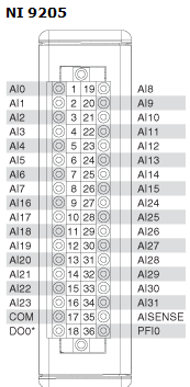

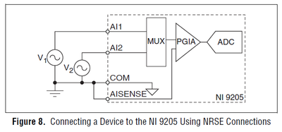

I want to make sure that you have your 9205 connected properly.  This document covers the finer points of the different wiring configurations. Also the manual of the 9205 will show you the proper configuration for NRSE.
 Ensure that your COM and AISENSE are connected as well as the ground terminals from all of your signals.  Also consider the length of the wire that connects your transducer to the 9505.  If you are still receiving issues try a differential measurement by connected the ground to AI8 and the signal to AI0 to see if that will give you the expected measurement.  Also as a tip, start with one channel and add them one at a time.  Reply post if you have further questions!
