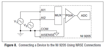

I want to make sure that you have your 9205 connected properly.  This document covers the finer points of the different wiring configurations. Also the manual of the 9205 will show you the proper configuration for NRSE.
 Ensure that your COM and AISENSE are connected as well as the ground terminals from all of your signals.  Also consider the length of the wire that connects your transducer to the 9505.  If you are still receiving issues try a differential measurement by connected the ground to AI8 and the signal to AI0 to see if that will give you the expected measurement.  Also as a tip, start with one channel and add them one at a time.  Reply post if you have further questions!

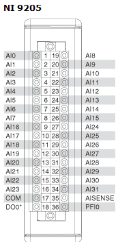

As an update, I have tried everything I can think of and it is not a problem with my circuitry. I have taken a DB37 connector and connected all pins together except pins 9 (DO0) which I left unconnected, and pin 20 to which I connected an Agilent E3631A power supply set to 2V relative to the grounded pins. On all 3 of my 9205 modules (2 NRSE, one RSE) I can reproduce the behavior of channel 24 reporting 1/2 of channel 8 (so ch8 has 2V, ch24 has 1V), even though channel 24 is grounded.
I am using the recommended software set for RIO 3.0.1 with scan engine support along with advanced i/o support and the 2009f2 patch. I have confirmed that this behavior happens whether I address the channel using advanced i/o or whether I call the channel directly using the variables under the module in the project explorer. I have not tried using FPGA mode, only scan engine interface. Right now, I am thinking it is most likely a bug, but if you have any sugestions I will try them.
Jon
Edit:
 To clarify, I have the D-Sub version of the 9205 and my DB37 connector is directly connected to the module so that there are no external effects.
