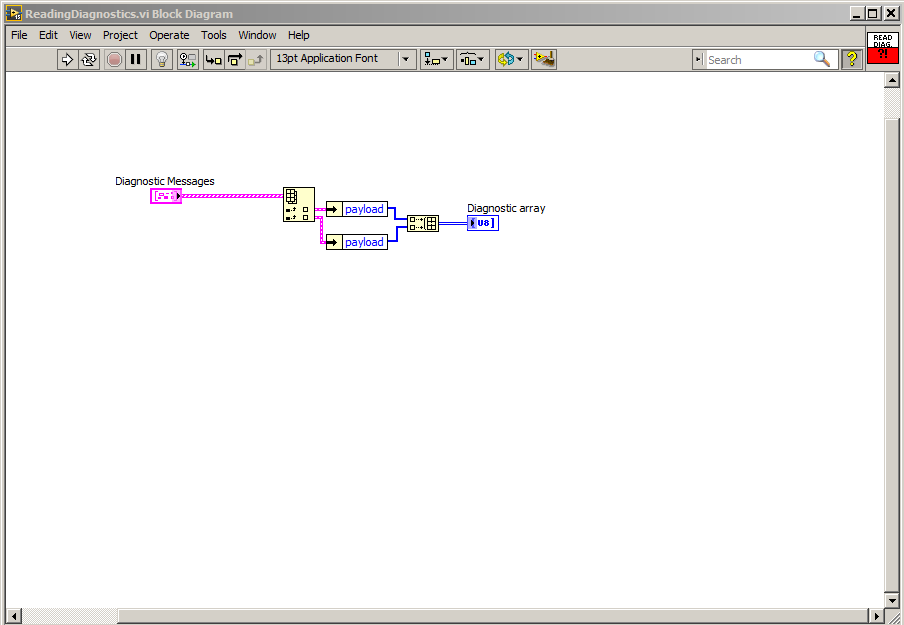

So I realized what my mistake was and it was down to a dumb mistake on my part.  I was using a Build array function inside a while loop which unbeknownst to me was just adding the new values to the old array each iteration causing my out of memory issue.  I was under the impression it was discarding the old array and building a new one each iteration. Below is shown the offending code. I changed it to initialize the 2D array of U8's outside the loop, pass it in, then just replace the values each iteration.  Seems to have fixed it.
