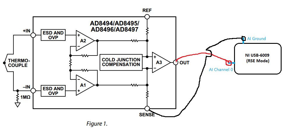

I think connection to USB DAQ card should be..!!
Connection

But don't you think I should ground my power supply or so? how about the reference pin?
Message 7 of 8
(4,936 Views)
I did that as you said and in my case the voltage output now is around 300 mV which is similar to expected, however the temperature is not (using the VI file been attached), are you sure it is not missing anything else?
