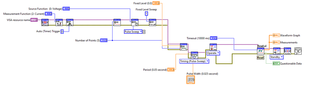

Hi GerdW,

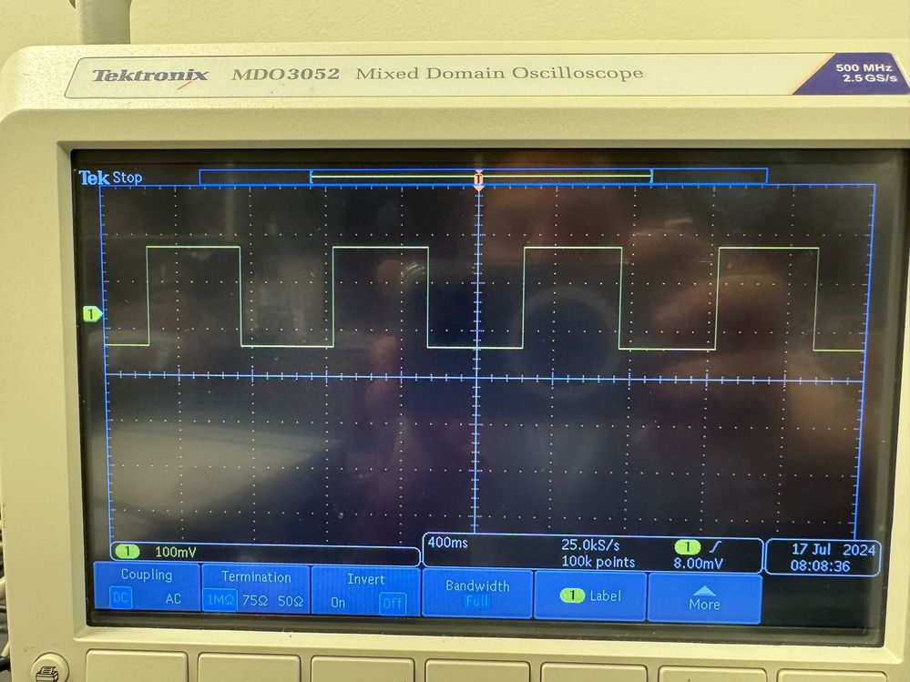

The attached is my main VI for running the 6240b current source. Using it, I can generate step current. My aim is to probe the resulting step voltage response. This current source has the ability to measure the voltage itself. Now this VI's output is just the voltage points you can specify in the front panel. What it actually does right now, it generates for example 5 periods of step current and it outputs five voltages in the level values. But the point is that I want to see the voltage output real-time like the what I can observe on oscilloscope. Do you have any suggestions on how to do that? How can I make sure that the device itself has that ability? Will I need any external DAQ device?
The main VIThe main VIProbed voltage change using oscilloscopeProbed voltage change using oscilloscope
