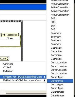

What is strange is that When I right click on the execution,  The properties and methodes open up with many duplication such as 3 open methode, 3 close methodes...

I'm not exactly sure what you mean by duplicate properties and methods - can you post a screenshot?

yes, it does show 7.0.3300.0 in the assembly folder.  Here is the screen
 for that screwup propertyof the recordset.

I have opened your code in LabVIEW 8.5, 8.6, and 2009.  Each environment, the same behavior occurs.  Therefore, I believe this is a new issue and I will report it to R&D (CAR #180836) for further investigation.  I did notice that is only occurs at the “Recordset” and “Connection” Nodes.  I also noticed when one of the parameters is selected, it chooses each instance therefore not messing up the code.  It is simply unexpected behavior.
