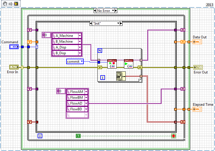

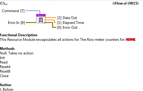

My 1st question:
I am not really sure what a wrapper VI means? Is it a subVI, where the certain AE subVI is called dynamically? I could not find examples showing how to do this (I read through the entire post, but the later discussion was more about OOP...)
Lets get into an example:
Here is a "Special" AE of I style I do often use (You can probably see it elsewhere to)
Note: using an AE this way I have only 1 point of access to the  resources and can easilly find the caller that hosed up my resource as well at troubleshoot the darn hardware!  BONUS you have a single point, correctly scoped, to document what the code does:

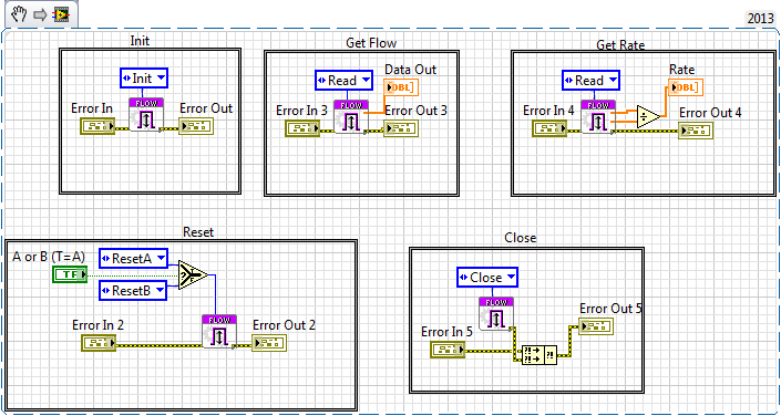

Works great until the project gets into multi- developer land or you need to really get righteous with your reuse code that might make it into follow on projects. Then you want to wrap up that Resource Module.  The BDs might look like this:
This allows me to publish an API for the resource that does protect critical actions on the code (And even has correct error functionality for the close operation)

looks very interesting! 🙂
and nice thing also, if there is an incoming error, you still close properly the HW resources...except if there is error in 1 of the 4 hardware, am I right? So if 1 HW (or channel) makes error, it will effect the 3 others?
Message 7 of 10
(7,179 Views)
I'd have to see the exact code to make sure, but most of the "close" functions in LabVIEW will still operate properly even if there was an error on the error input.  So it might be a non-issue.
Message 8 of 10
(7,156 Views)
The RM has an error/no error case. But close could put the error chain on a auto indexed tunnel followed by a merge errors.
