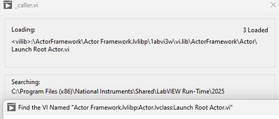

Then, I build the exe (in this case I turn off the exclude dependent lib option) and I get a program that has all the dependent libraries (which I built in the previous steps) copied to the data folder, as I expect. But when I run the program, it tries to find the typedef control from the library I built in the first step, but it doesn't find it in the data folder at all.
Question: what am I doing wrong? How can I tell the program new paths to lvlibp?

And when I run exe, I get search window for all components

Beyond that though, the actual issue is due to how you are building the PPLs, and then building the EXE. The EXE is copying the PPLs into the data folder, so the PPLs are all next to each other. But when you build the PPLs alone, you are putting them in subfolders. So when the exe is built, and copies them next to each other, it's a separate hiearchy structure and won't work.
You should just build the PPLs to the same folder instead of separate folders (with the Actor Framework.lvlibp in that folder to begin with). Otherwise you have to duplicate the folder structure when you build the EXE.
