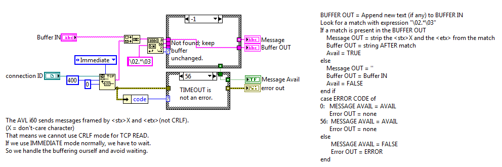

I had to solve this recently.  Basically, the solution I used involves my own buffering.
READ (Inmediate) with ZERO time out.
2... Append whatever is received to the local buffer
3... MATCH PATTERN with a string of \02.*\03
4... If found, then a message is available. do a STRING SUBSET with offset = 2, and length of STR LENGTH - 3 to strip the <stx>, don't-care, and <etx> off.
5... If FOUND, then set the BUFFER to whatever is AFTER the match.  If NOT found, set the buffer to whatever is BEFORE the match (which will be the whole buffer).
6... Check for TIMEOUT and treat it as NOT an error.
(I'm in an intense environment and can't wait around for messages).
400 is just a number I chose to cover the longest expected single message.  That gives us the best chance to receive a message in a single operation.
It'll still work otherwise, though.
For multiple devices, simply manage multiple clusters, each with a buffer and CONN ID.

BEWARE:  The AK spec says that each message starts with an <stx> character and then a DON'T CARE character.
In fact, a lot of instruments DO care, and want that character to be a space.

Attached is an LV2013 LLB file with RECEIVE and SEND routines, if anyone is interested.
NOTE:  The above code, which I submitted Apr 2013, has an error:
If the buffer contains TWO complete received messages, then the expression "\02.*\03" will select everything between the FIRST <stx> and the LAST <etx>, which is incorrect behavior.
The correct expression is "\02.[~\03]*\03" which means <stx>, any char, any number of chars EXCEPT <etx>, <etx>.
That is corrected in the samples given.
WIth this change, if the buffer contains two or more messages, then only the first is extracted: the subsequent ones are left in the buffer (for extraction next call).
I should point out that the actual TCP Receive is not in this example code. The TCP receive is elsewhere, with a timeout of 0.  Pass in the ERROR and DATA RECEIVED into this RECEIVE vi.
