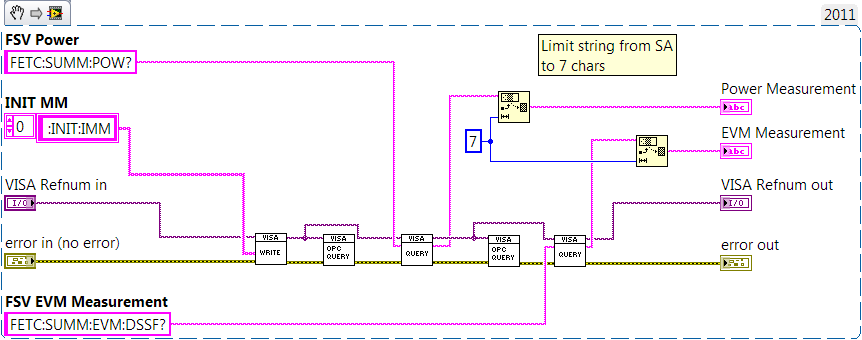

The main acquisition loop has two measurement sub VIs running in parallel to grab data from the instruments. I've attached the VI (the most I can attach) - this VI runs in parallel with itself in the main run state of the loop but with different TCP/IP VISA resources at the input.
The OPC Query is a piece of legacy code that I cannot change and the implementation is very redundant.
At the end of each grab I write the strings to a spreadsheet using the Write to Spreadhseet File VI but I've also disabled this part and the bahviour didn't change.

It's the most I'm allowed to attach.. can't share anything else due to NDA etc.
The slow behaviour occurs when running the state which contains the code I've attached.

The main 'Run' case of the state machine is in the timeout case of an event structure - I've been changing the value of the timeout to see what difference it makes (I plan on using 1000ms). When I run it first in the dev environment after changing the timeout value, the acquisition speed changes. But moving to the executable means the aquisition slows down to about 3-4 seconds. In the run state I'm writing the values I get from the analyser to a table on the front panel with a timestamp (with millisecond resolution) so I can see the difference between each data grab.
For any FOR loops with VISA read/write functions within them I use the Wait Until Next ms Multiple timer to time the loops (rather than letting them free-run) - I've played around with the value of this too but it makes no difference once the exectubale is built.
For the network comms I just used the standard VISA read/write functions with the VISA resource name set to the IP address of the instrument (e.g. TCPIP0::172.16.118.100::inst0::INSTR, which I grabbed from MAX).
