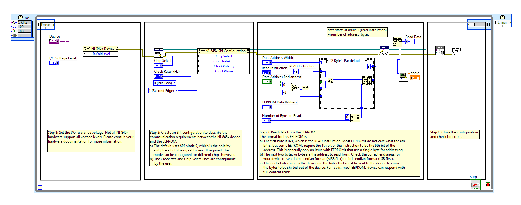

I am actually working on a cell AS5048A and I have got some issues.
I am trying to get angular information from the AMS cell AS5048A which is communicating with SPI interface.
I am using a software Labview and an USB-8451 from National Instruments.
I connected the AS5048A to a PCB dedicated.
According the the Datasheet of AS5048A, I try to access to the register x3FFF to get the require data.
The command package is the following one :
So I made this software to send information :
The only answer I have on my MISO signal is the address sent on the MOSI.
Did I make a mistake ?
Why the cell answer me the address sent ?
Thank you.

Thank you for your answer. Before posting on this forum I did a lot of research, and as you say, their is a lot of subject dealing with I2C interface. The matter is that I2C and SPI are very different and this is really complicated to do the analogy.
I will continu my research.
