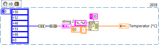

@milan87 wrote:
Hello all,
I have array of ascii numbers which I need to translate into number.
I used type cast, to convert each byte into decimal number, then concatenate into string.
This string contains multiple ''space'' characters, so I cannot translate this string into number.
Message 2 of 8
(3,555 Views)

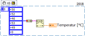

Or:
It's not clear what the \00 should do, separate numbers or end the one value...
The main problem in your solution is that the numbers are I32s. Converting them the characters (U8s) will give you 4 characters.

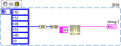

I Think this is what you want:
Message 5 of 8
(3,486 Views)

wiebe@CARYA wrote:
@milan87 wrote:
Thanks all for quick support.
Values are from ftdi chip, which use dll, for sure written in C.
If it returns I32s when it should return U8s, something's suboptimal at best, wrong at worst.
I suspect you can do something more like this so that you have the string directly (one less conversion that needs done).
