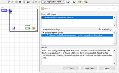

Please note that this question is about a single for loop configured to run in parallel (per the image following). It is not about multiple loops running together.
When I have a process that may take a long time to complete, I like to offer the user a means to abort it. They may have initiated it accidentally, they may change their mind partway through, they may realise they have given it the wrong parameters, or it may have some fault (either in the code or in user-supplied parameters) that means it will never complete, or will take months, or will consume all available resources and crash.
In a computation that takes place in a regular for loop, I achieve this using the (optional) conditional terminal to break out of the loop. However, in a parallelised for loop, this terminal is not permitted because some of the later parallel iterations will have completed at the point it is terminated.
It seems to me there is still value in being able to break out of a parallelised loop, i.e. having a global conditional terminal. For purely calculational loops, it would also be possible to simply throw away any subsequent iterations, regardless of whether they had already been calculated or not. This would allow the early completion of some classes of calculation. The presence of nodes within the loop already generates a warning that they may cause side effects, which would be the worst that would happen if a loop terminated prior to an already-executed iteration. Am I overlooking some deeper problem? Is there any other way to achieve my aim?

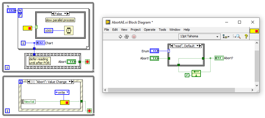

All you need is a small action engine that acts as critical section and bypasses the heavy lifting in the parallel FOR loop if needed. If abort is true, each iteration only executers an empty case.
(EDIT: slightly improved code attached)

Just some further comments on my solution above
I have a relatively old fitting program that takes great advantage of parallelization. It scales well with the number of cores.
Here, the abort engine is actually read inside the fitting model subVI. It gets written when the user hits the <esc> key, causing the model to return with error  43. ("Operation canceled by user") and stops the parallelized process similar to shown above. Once the fitting completes  (with error), the signal needs to be reset in the main VI.
