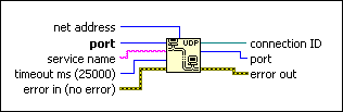

UDP Open Function
https://www.ni.com/docs/en-US/bundle/labview-api-ref/page/functions/udp-open.html
net address specifies on which network address to listen. Specifying an address is useful if you have more than one network card, such as two Ethernet cards, and want to listen only on the card with the specified address. If you do not specify a network address, LabVIEW listens on all network addresses. This function broadcasts only on the default network address.

Unfortunately the documentation you provided did not solve much: indeed, I use the "net address" input of OpenUDP exactly to select which way to communicate with the hardware.
The problem is that if I tell labview to open the UDP socket using one netword card, everything is fine. The other is slow.
