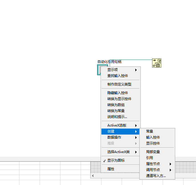

I want to call excel, but after selecting the library, labview does not respond. What if I cannot find the property node inside to create?
What should I do? Is the path of the library to be adjusted?

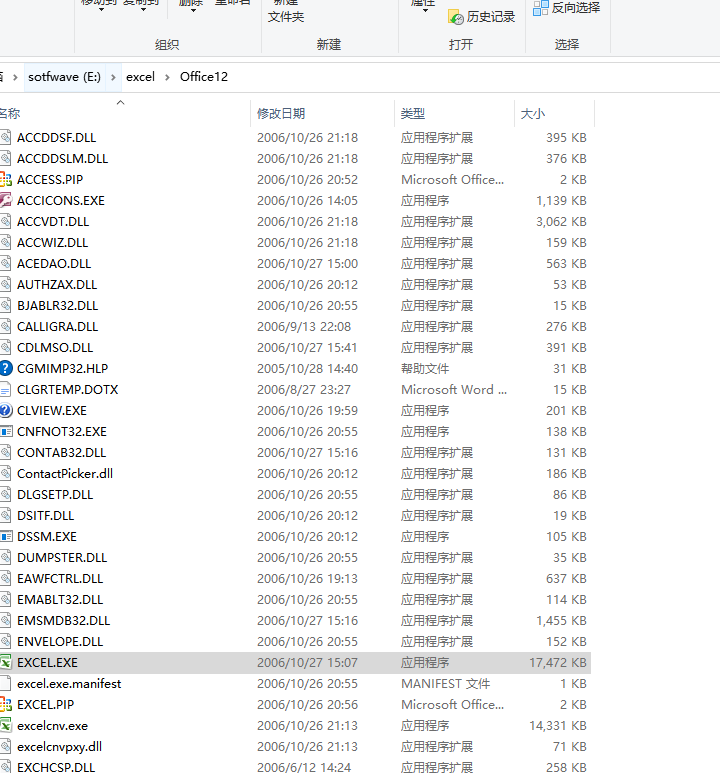

But I don't know which import library worksQQ截图20200602163302.pngQQ截图20200602163329.pngQQ截图20200602163335.pngQQ截图20200602163352.png

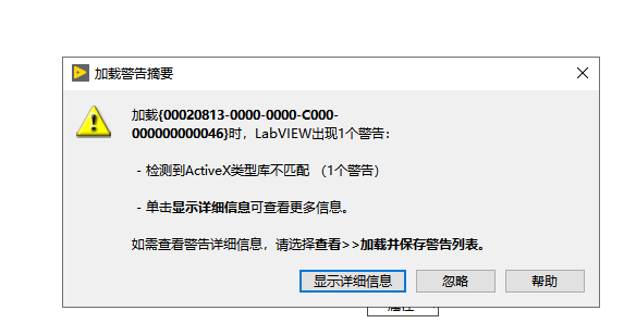

When I create an attribute node to reference Excel application, I report an error that it does not match the type library,
I guess it's the library file that hasn't been used or what's going on, or there's something wrong with downloading exceQQ截图20200602201821.png

Ah, you are using ActiveX, and doing Excel "the hard way".  Plus you appear to be using a Chinese-language Version of LabVIEW (but possibly the Function Icons will be recognizable or "click-able").
