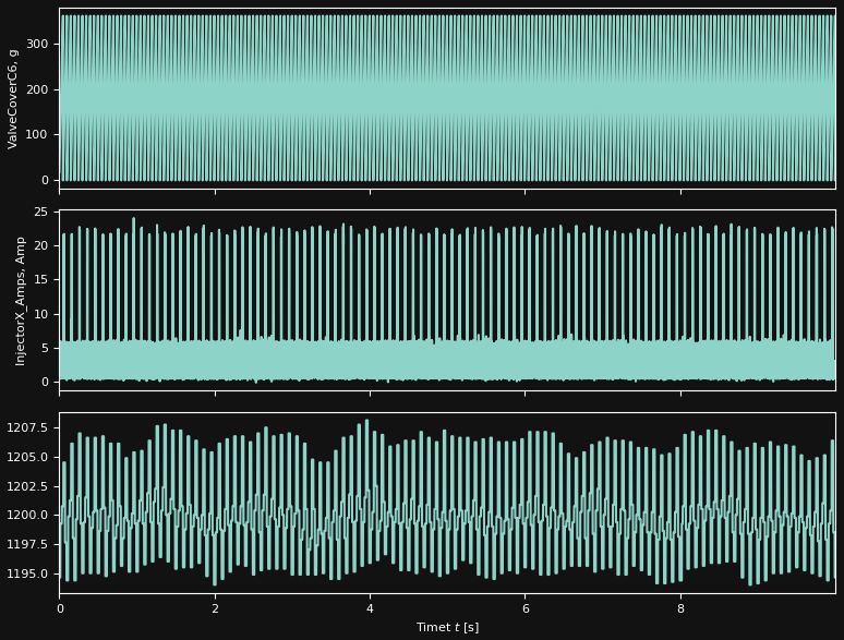

Note:Top graph "ValveCOverC6" is actually Encoder (0-360deg)

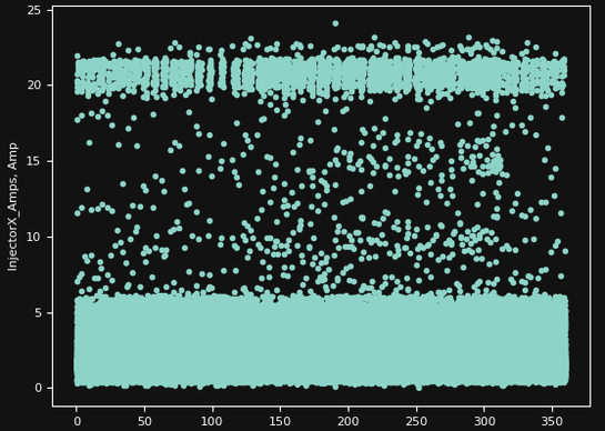

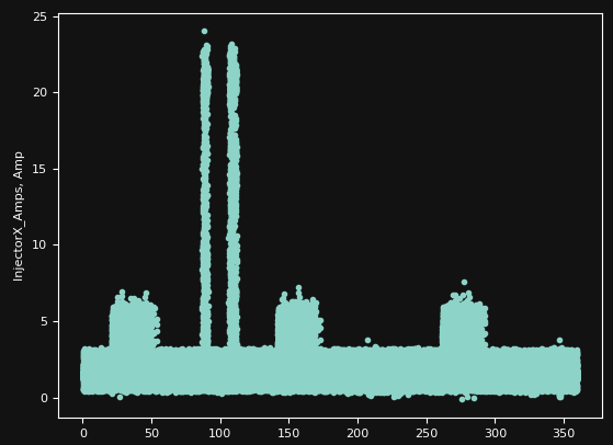

Injector Current vs Angular Position (Crank Angle Degrees) at a static speed (1200 RPM):
You can see that the current pulse is always between an indicated 90deg and 120deg. If the encoder output was drifting position during this, you'd see a much wider band from those two high current traces (Ignore the shorter ~6amp pulses, those are something different).

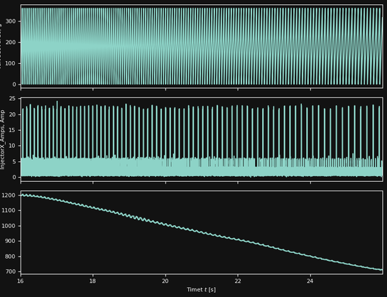

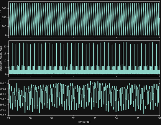

Below you will see a transition from 1200 rpm to 700 rpm. You will see the perceived phasing of the injector during this speed change. Then there a screen shot of the data of it resting at 700RPM after the decel event. You'll notice that the injector is back to a steady value but much different angular location than what it was at 1200RPM.
Transition 1200 to 700
 Injector Current vs Angular Position (Crank Angle Degrees) at a Transition

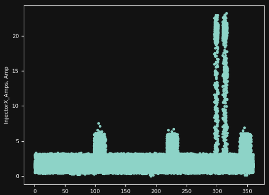

Static Speed (700rpm)
Injector Current vs Angular Position (Crank Angle Degrees) at a static speed (700 RPM):

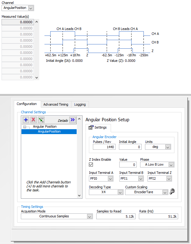

LabVIEW Setup:
I've attached my VI and project.
AngularPositionTask
Questions:
How exactly does LabVIEW calculate "anglular position?" I know that's a broad question but by that I mean, if I am sampling relatively slow, slower than the position is changing, is LabVIEW calculating a new angle every time a pulse comes through despite the slow sampling and when it is finally sampled, it will send out it's current position?
How is it possible for my zero to be off consistently if I have and am using the provided Z channel reset?
How to a fix it so that I can sample the position at 51200Hz and have it such that the position is absolute to a known reference (z channel)

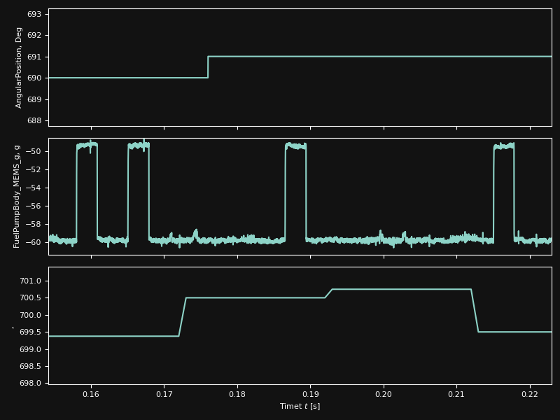

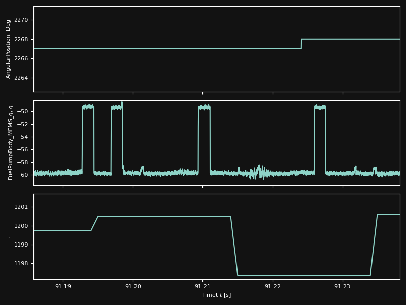

I just saw your message and haven't had time to unpack all of it either or add the readnode idea but I appreciate the input. In the meantime I did go back and just monitor the z channel alone and that appears to be shifting; so it's not necessarily the daqmx angle calculator.
The double pulse in the encoder data is to reinitialize the ECM to cylinder 1’s cylinder event; coupled with the crank sensor the ECM knows exactly where the engine is at both angular position and cycle (Combustion, Exhaust, Intake, or Compression).
You can see in the first image below that the Z channel increases between cylinder 5 and 3 (Firing order 1-5-3-6-2-4 where the double pulse is Cylinder 1) This means the Z channel is triggering between approximately 120 and 240 CAD (Closer to 240). This z channel input should always stay in the same position relative to the cam sensor. In the second image, at a different engine speed, the Z channel indexes between Cylinder’s 1 and 5 or 0 and 120CAD.
