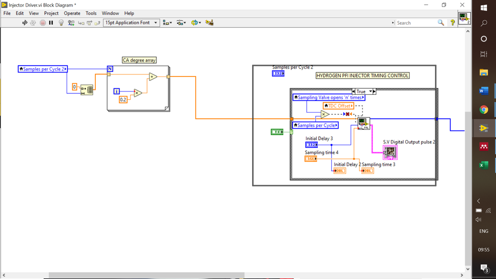

I've attached the pictures for the other previous setup which uses the CAD array as both the timing and duration of the pulse signals. As I said, I had hoped to be able to (relatively easily) create a time controlled pulse depending on whether the sample number had reached beyond a certain sample number, and maintain this existing setup for the timing of the pulse.

I've attached the relevant snapshots of the current set-up which may help.
I was using samples to describe in the input and the pulses to describe the absolute time-dependent output.
I believe the DAQ card being used is an NI PCIe-6323
