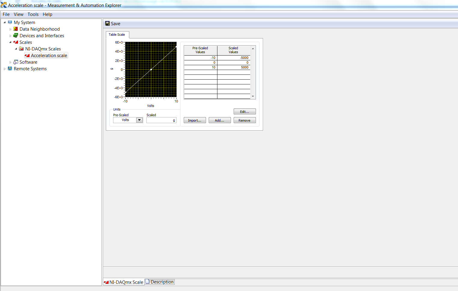

Thanks for your replies. I have attached how the graph looks like in a pdf file. g is the Earth's gravitational acceleration of around 9.81 m/s^2. Please find below how the scale was configured using MAX.

0.5 mV/g * 10000 g = 5 V.
It appears from the fuzzy image you posted earlier that your scaling is reversed: 5000 g => 10 V.
