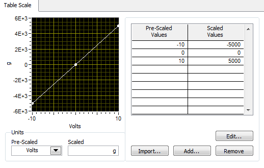

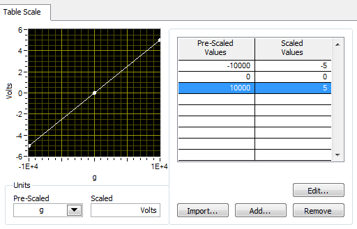

The range settings (g) on the power supply have or +/- 5V or +/- 10 V. Shall we then select 5Volts and specify in the MAX scale, the reverse setttings that
- 10000 g= -5 Volts
0 g= 0 Volts
+10000 g = 5 Volts?

I would leave the signal conditioner at +/- 10V to avoid clipping the signal.

My hints:
-Set the conditioner to gain 1
-Use +-10V input range
-Scale the result in your LabVIEW program.  If you have access to the sound and vibration suite use it for aquisition and scaling.
You don't loose that much resolution ...  your measurement uncertainty is 2.15% for sine calibration accoring to the cal-sheet and since you measure transient small peaks with power in frequencies >10kHz  you migth end with 5% anyway....  If you match gain and range it's just a factor ~4  but you wouldn't capture out of sensor range peaks that easely occure with such tests.
Finally: If you do further calculations you migth end up in using metric units (m/s²) anyway 😉
