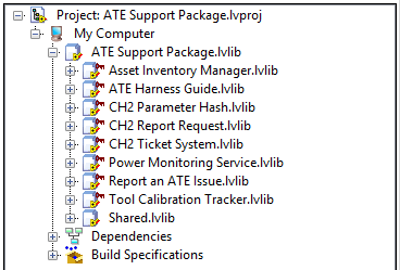

Is there a reason why I can't define the access scope of a library until a place it within a virtual folder? All I want to do is make all these libraries private just as they are now, but instead I either have to put them into a virtual folder (which I don't want to do because I'm particular about my file structure) or make each of the individual members of the library private (which could get annoying if any one of these ever get very large).

I guess I'm content with this. Still wish I could just privately scope them without encasing them all in a wrapper library...

I am confused by what you want now.  If the libraries were not inside of another library (or class) and the entire library was private, it would be useless because nobody could access it.

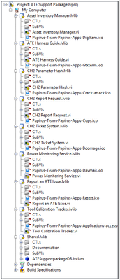

Each of those is its own standalone application (except Shared.lvlib), and I want to be sure that there were no dependencies of application A that exist in application B's library. Any code that application A uses should either be in "application A.lvlib" or "Shared.lvlib" and if that's not the case, I want a broken run arrow so I know something's up.
I realized right after doing it that my last picture definitely does not achieve this, as privately scoping those libraries just means that their contents can only be used in "ATE Support Package.lvlib", not that each library is independent of every other library (again, except Shared.lvlib).
So now I'm back to this. I think I just thought about it too much and confused myself with privately scoped libraries vs. virtual folders vs. classes vs. individual members of each of those things.

Just to be clear, so based on your previous image of a Project Explorer, there's no way for anything outside of a library to call it, and presumably things like "Asset Inventory Manager.vi" is always intended to be a top-level VI (as is "ATE Harness Guide.vi", etc)?

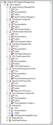

Exactly right, each library contains a top level app and different supporting files for only that app, again with the exception of Shared.lvlib which is where I'm going to put files that more than one app uses. The way this project has been going, I could easily see there being 30 different apps in a few years so I'm trying to get this proper structure now as a way of future proofing.
I did do one more thing and made Documentation folders for each library and put the app icons in those folders. Looks even cleaner now. Including a pic of the build specs because why not.

@FireFist-Redhawk wrote:
What you are showing here is exactly what I do except I tend to leave the top level VI as public.
