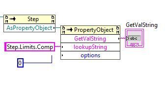

What is the lookup string to access the Comparison type selected for a (Teststand) Numeric Limit test step type in LabVIEW?
I tried using the Step.Limits.Comp but it didnt work. Also does it use the GetValString?Comparison type.JPG
(2,717 Views)
Accepted by topic author GoKu25
you need to change the look-up string to "comp" if you are in the sequence context of the executing numeric limit test.
