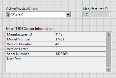

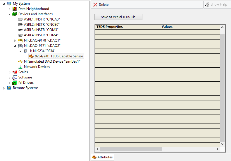

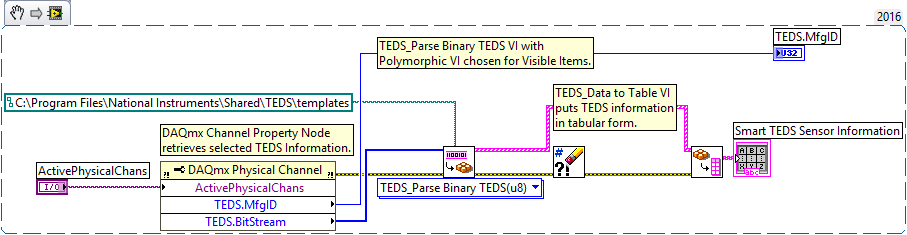

I am using B&K 4189-A-021 teds enabled microphone along with NI-9234 IEPE module. (Note: There is no user configured TEDs information available with that sensor.)  When I read the teds information using the cdaq chassis (Ni-9171) with the following code it gives result as shown in picture 02. However when I saw the sensor TEDS information in the NI max shows empty (Picture 03).

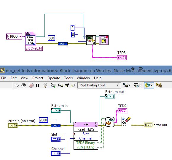

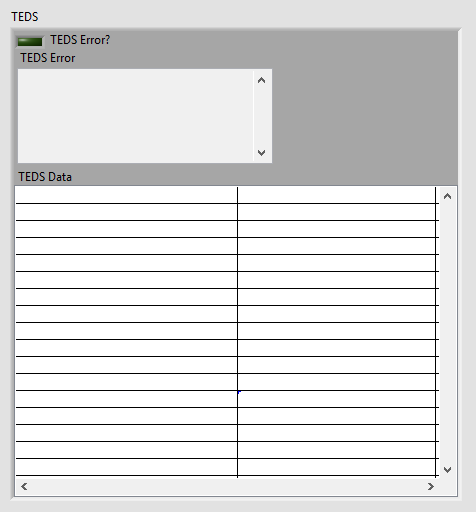

But when I tried read the same TEDS information on the cRIO platform using the below code (picture 04) I am not getting the above said TEDS information.
